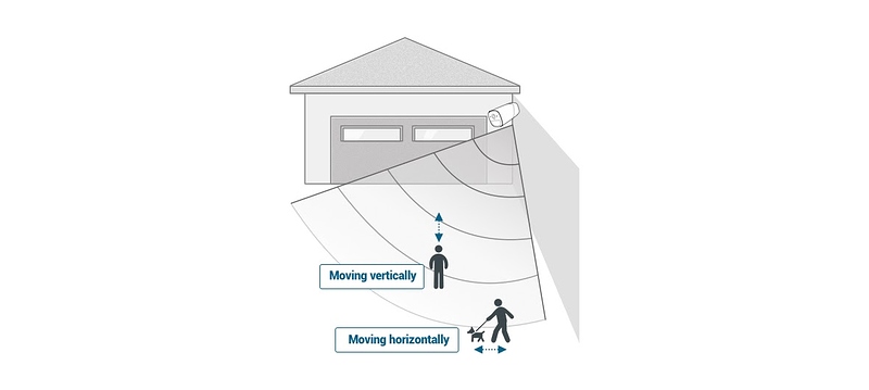

What should I do if the camera occasionally misses some events?
Installation position
Select a suitable installation position for the camera to ensure that each motion event can be captured.
  1. Point the camera in the direction of the path with the highest probability of people moving in the area.
  1. The optimal installation height is 2-2.5m(7-8ft) off the ground. If it is too high or too low the detection distance will be reduced. It is not recommended to install your camera with a downtilt angle exceeding 25°. A large downtilt angle will also reduce the detection distance.
Detection type selection
The system defaults to Human Only. During the day, the camera only records human motion events and the app only sends push alerts for humans. At night, all motion events are recorded and push alerts are sent by the app for all events. If you want to monitor more motion events during the day, such as cars or animals, try switching to All Motions mode.
Sensitivity setting
The system’s default motion detection sensitivity is set at level 4. If you think that the detection distance is too short or it has occasionally missed some events, you can use the Motion test mode to increase the sensitivity and test the maximum detectable distance of the camera. Finally, adjust the camera’s motion detection sensitivity to the appropriate level to suit your home.
