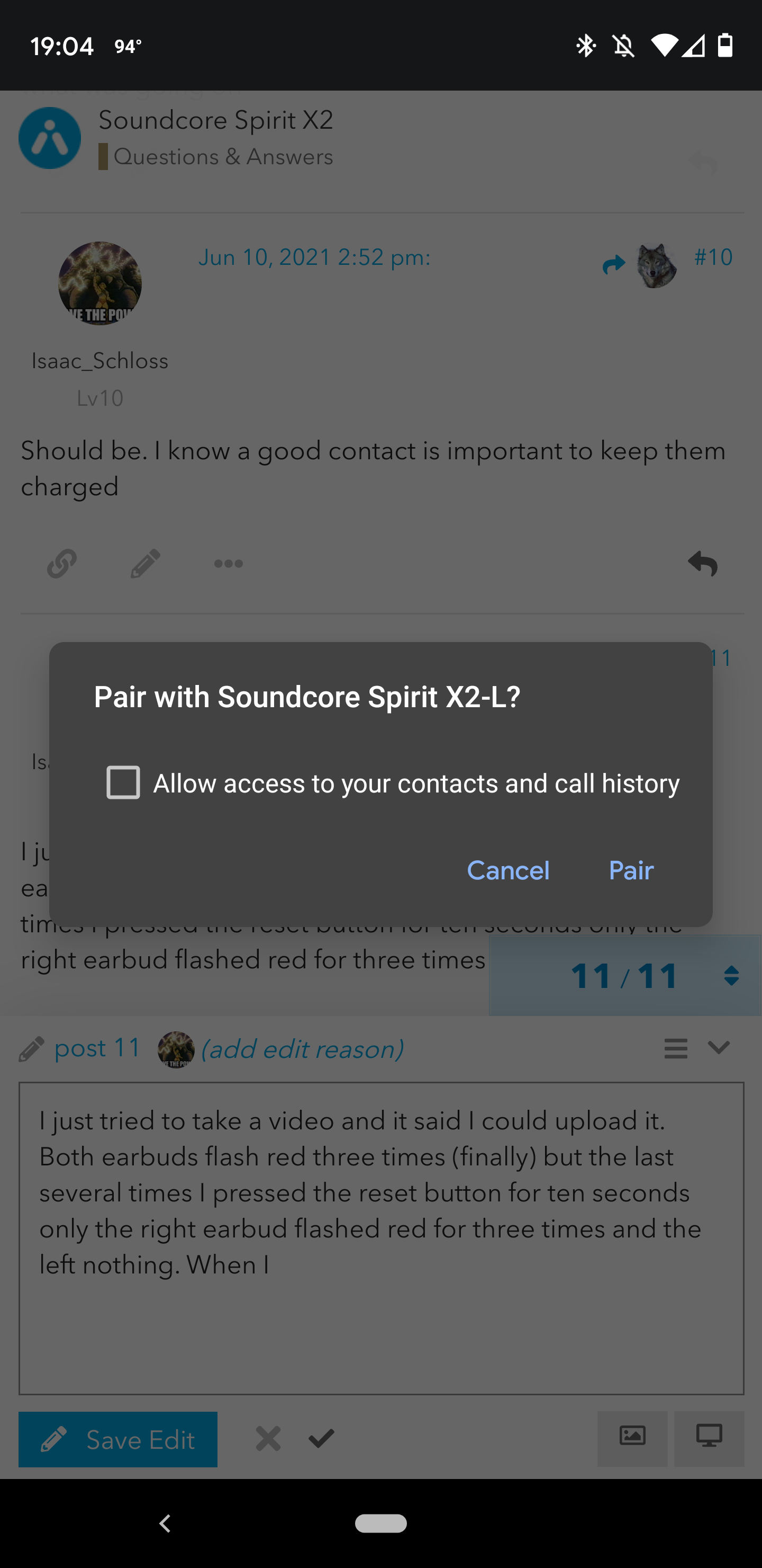

I just tried to take a video and it said I could upload it. Both earbuds flash red three times (finally) but the last several times I pressed the reset button for ten seconds only the right earbud flashed red for three times and the left nothing. When I went to pair the Bluetooth after I had it forget, Soundcore Spirit X2 showed up and then an -L showed up afterwards (attached photo)
like it’s not connecting with the left earbud

The pairing request to L bud is utterly normal and a good sign. Once a reset is succesful take out R bud, pair, it will then offer L bud, pair, done. It is to allow for putting R bud in case and then can keep working just with the L bud.
If you didn’t get L bud pairing before then that’s a sign of an earlier pairing problem and can be a cause of broken firmware upgrade.
