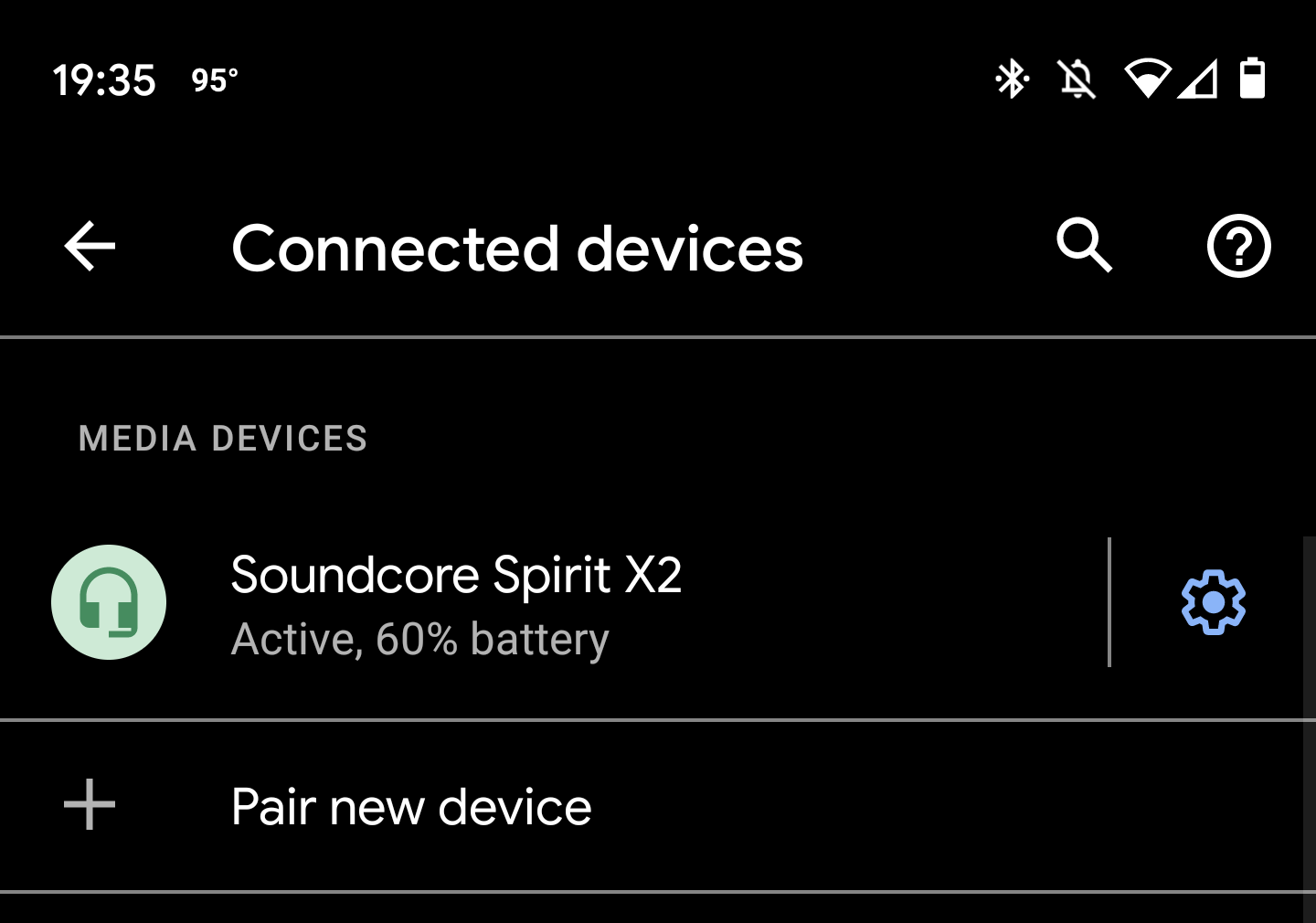

Charged the headphones in the case and three solid white lights. Says 60% so not sure what is going on. Just heard the words “normal” and then the headphones turned off. Just said bass up and then disconnect and then says battery medium but it said 80% then 60% and then 100% with base up being said and then it keeps disconnecting. I did two more resets as the first one just had the left bink red and then the second time both blinked red and not the left earbud won’t turn on
