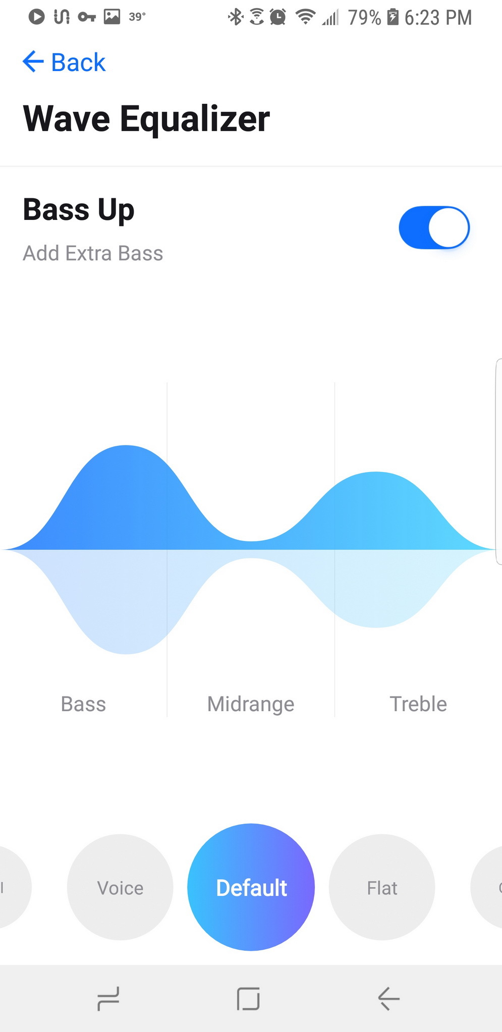

The controls under the grip are clear and intuitive. There’s a BassUp button, -, Play/Pause, + and Bluetooth buttons. The -/+ buttons control the Volume either by pressing on them or long-pressing for quicker adjustments (in the app you can change that to Previous/Next track). You can also control the Model Zero with the Soundcore app (I also use this app with my Soundcore Flare). There are built-in Wave EQ settings (no user customized EQ): Voice, Default, Flat, Chill and the BassUp setting can be turned on or off. A graphical battery indicator is always visible in the connected speaker screen. At the bottom of the app are settings for Standby Time of 15 minutes to 2 hours. When idle and the time is up, the device will turn off. You can also check to see if your speaker has the latest firmware and apply it.

I never used that application.
But as far I see there is really nothing which I need.
The presettings of the eq? Not enough for my taste.

Maybe @elmo41683 can confirm this if he has a late model Android phone, but I noticed that I can go louder using the Soundcore app and my Samsung S8 than with my iPad Air 2 using the iOS version of the Soundcore app.
For example, when I raise the Volume to 100% on my Samsung S8 phone via Bluetooth, in the Soundcore app it’s registered at 50% like in the 1st app photo above. I than can go even louder to the very end of that circle via the app.
This does NOT occur with the iPad or iOS version of the Soundcore app.

As you are using Android, which player are you using?
There are many, some for free, but offering a useful eq.
But I use the ZERO mostly in my “private office” connected to a laptop under LINUX:
As you see the volume is about 40% (This is OK for a small room)
But I can go to 100% and even more.
The volume at the speaker I adjusted to the highest level.
May be these two possible adjustments of the volume (source and speaker)
leads to confusions in your different apps (Android and OS)
Yes @Dez_S I have a Galaxy S9+ and I found that the volume reporting in the app is for the volume on the speaker itself. Which does operate separately from the phones volume. So if I set my phone to 100 percent I can then adjust the speakers volume up or down as needed.
This speaker sounds even better than I was hoping. Thanks for your review. One of these might be in my future!
