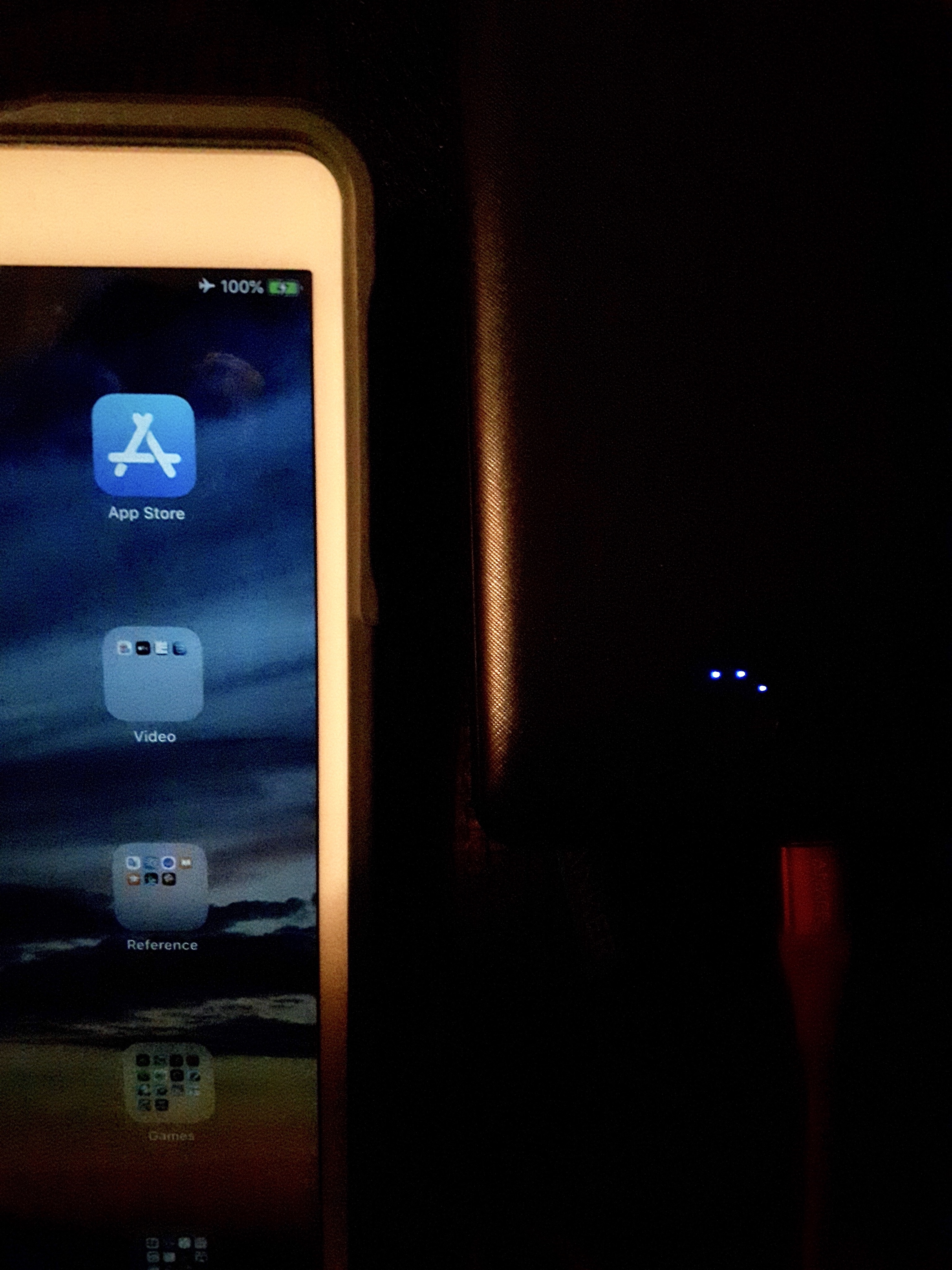

So, my super high-tech test.
I don’t have any fancy output testing gadgets so this is a real world charge of my iPad Pro 10.5” which has a 8134mah battery.
The following are screen shots at 30 minute intervals.
I used the USB C port and a PowerLine+ II 90cm USB-C to Lightning cable on a completely flat iPad (won’t turn on) with a fully charged PowerCore.
I’m not sure if the Jelly Baby helped or hindered the charging process :rofl:
18% in 30m
46% in 1hr
68% in 1hr 30m
87% in 2hr
95% in 2hr 30m
100% in 2hr 50m
Once the charge cycle was complete the PowerCore still had in excess of 75% capacity left - 3 blue LED’s illuminated.
In conclusion.
From initial tests this is an awesome PowerCore and will suit me down to the ground.
Pushing almost 50% charge into my iPad in an hour, well, that’s as fast as my Anker mains powered charger so I’m really pleased with that!
