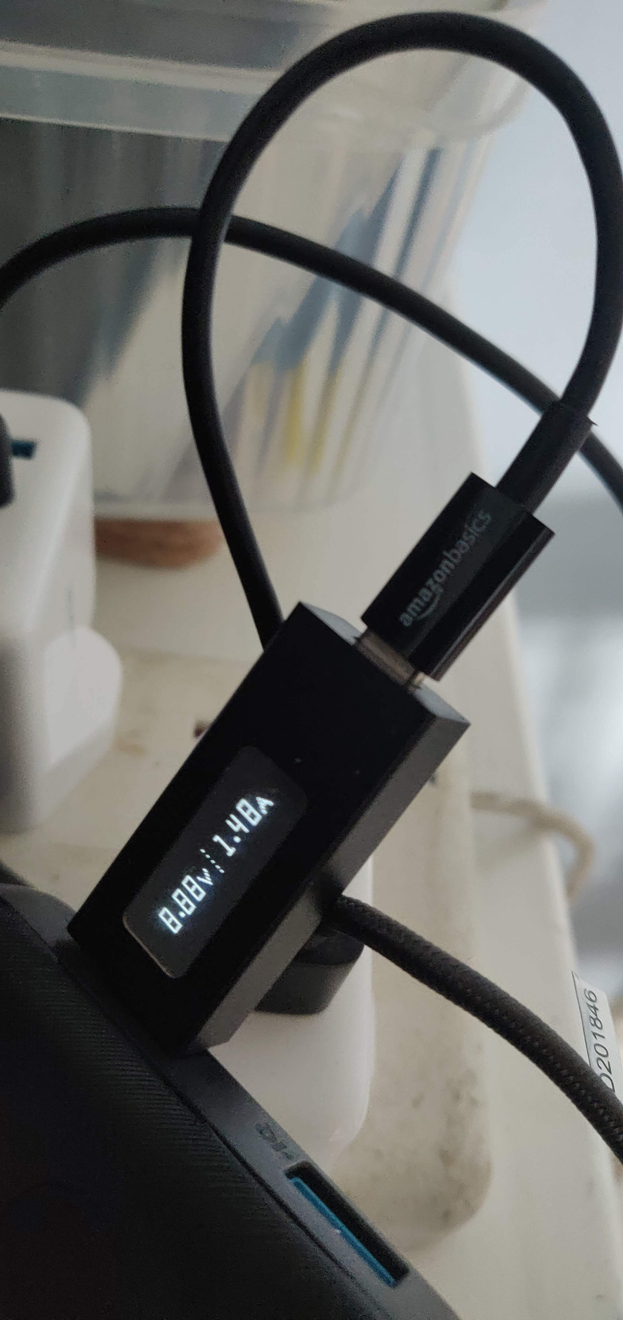

I drained my 20000 PD and now recharging, the fact it is as slow as 6-7 hours makes sense as it is not ingesting at 18W, I tried it with 3 cables and 3 chargers. The 18W charges give 8.75v 1.48A 12.95W, and the 30W charges at 15V 0.87A 11.28W, so ironically the 18W charger looks like it will be faster than 30W charger.
The Thunderbolt 3.1 cable is giving 8.82V 1.45V 12.89W, vs the supplied cable 8.75v 1.48A 12.95W so ironically the better cable works out a 0.5% slower.
I also tried with non-Anker Amazon basics USBC 2 cable only rated for 5V, but it actually performs better than any of my Anker cables, it is 8.88V 1.48A 13.14W so 1.5% faster.
So the maximum irony is the slower charger and cheapest non-Anker cable is performing the best.
I’m leaving it with the fastest combination to recharge and will report back later. I can’t push more than 13W into a “18W” recharge so at 72Wh means a minimum excluding trickle-charge phase of 5.5hr, assuming trickly charge kicks in at 85% then 0.85x72/13=4.7hr until trickle charge then assume say 5W til the end so 0.15x72/5 = 2.16hr for a forecast 4.7+2.16=6.86hr.
EDIT: trickle charge kicked in 5 hours into recharge, 9V 1A, then dropping steadily 9V 0.8A.
EDIT 2: left it and came back to it fully charged, so do not know actual elapsed time but 6-7 hours is believable, it was trickle-charge 6.5hr from empty.

So that USB gadget, does it show the details of the charge the PowerCore is taking or whats coming out of the charger?

I recharged the 20000 PD then plugged into a 70% charged device, was giving 8.97V 2.06A = 18.48W out.
So its output is as claimed, its input is not 18W, is nearer to 13W, but probably the 6-7hr recharge is about-right against claims but a true 18W recharge would be faster. To say 9V 2A input when its more like 9V 1.5A input is a tad of a stretch.
