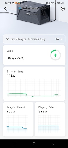

Another update:
The battery got today the update to firmware V 1.3.0.
Currently there where still drops during charging the battery for some reason.
I hope for better weather to get more information.
I never had such drops as long my panels where connected directly to the Hoymiles.
After using the battery for two days i can say that there is lot of space for improvement
@Anker: here are my suggestions which are for me (and i think also for others) importand
- Why does send the battery energy to the micoinverter when i turn “Familienladung” off? When i turn it off, i would like to store the whole power in the battery.
- Why is there a lower limit in “Familienladung” of only 150 watts??? I have a much lower consumtion (aprox 50-70 watts) during nighttime. I waste half of the soraged energy!
