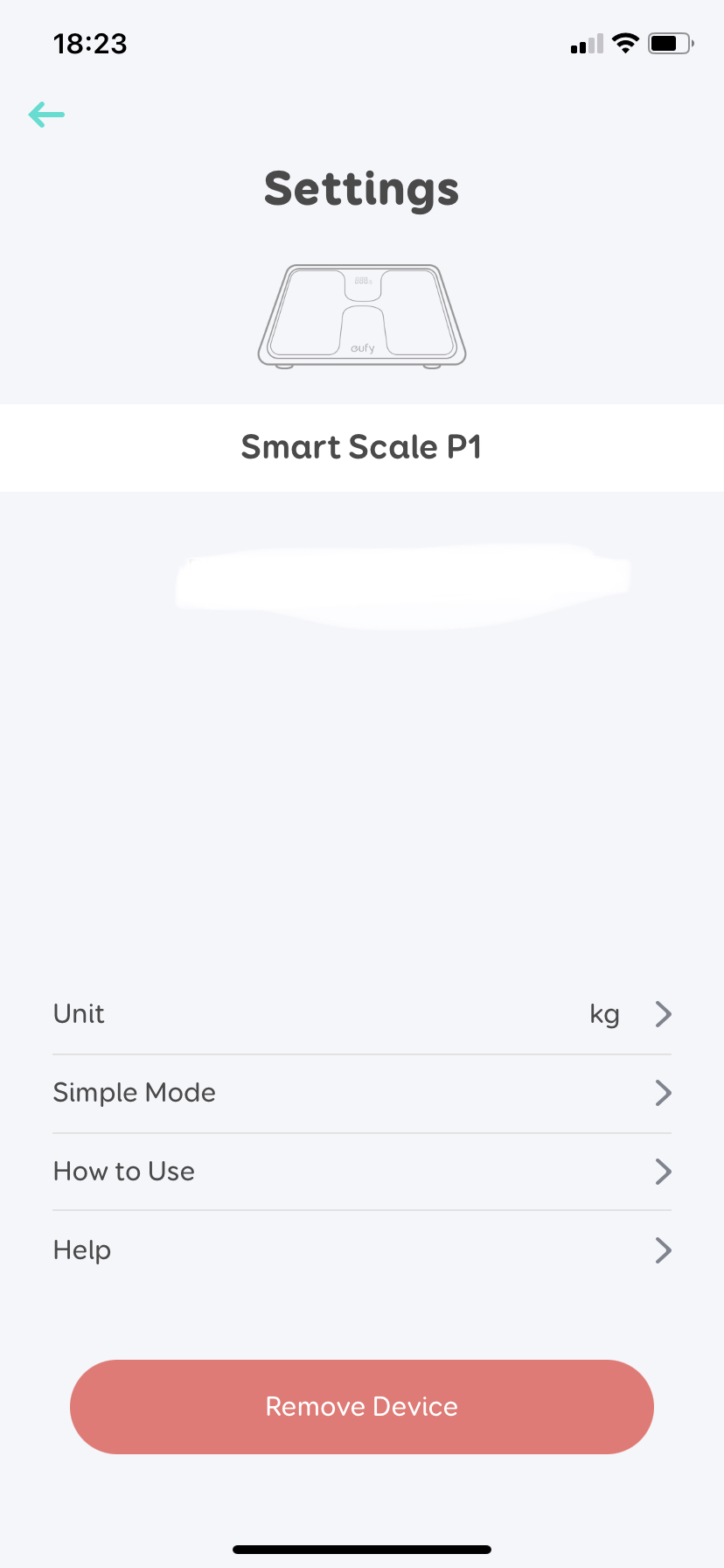

“Simple Mode” was turned on. That is why I was not getting all 14 measurements. Moving forward turning the feature of fixed my issue. I am not sure why it got turned on. Maybe it thought I was pregnant. :wink:

Posting screenshots as help for others
Great result @bmkcreative
