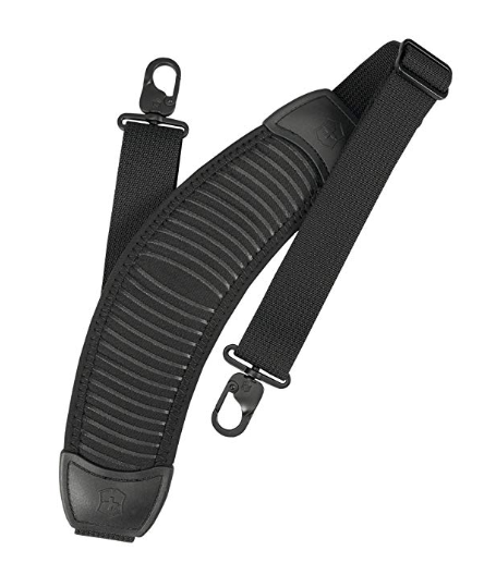

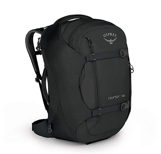

I agree that it is a bad idea for traveling. You would have to dig out the battery pack if TSA requires to check it. BUT for school and regular daily use this should be fine. It is not a feature I look for in a bag anyway. BUT this Osprey Porter 46 is my travel carry-on bag and I love it! Fits all my laptop, accessories, speaker, and then some… a lot more some. Couple it with a Victorinox Shoulder Strap and your golden!

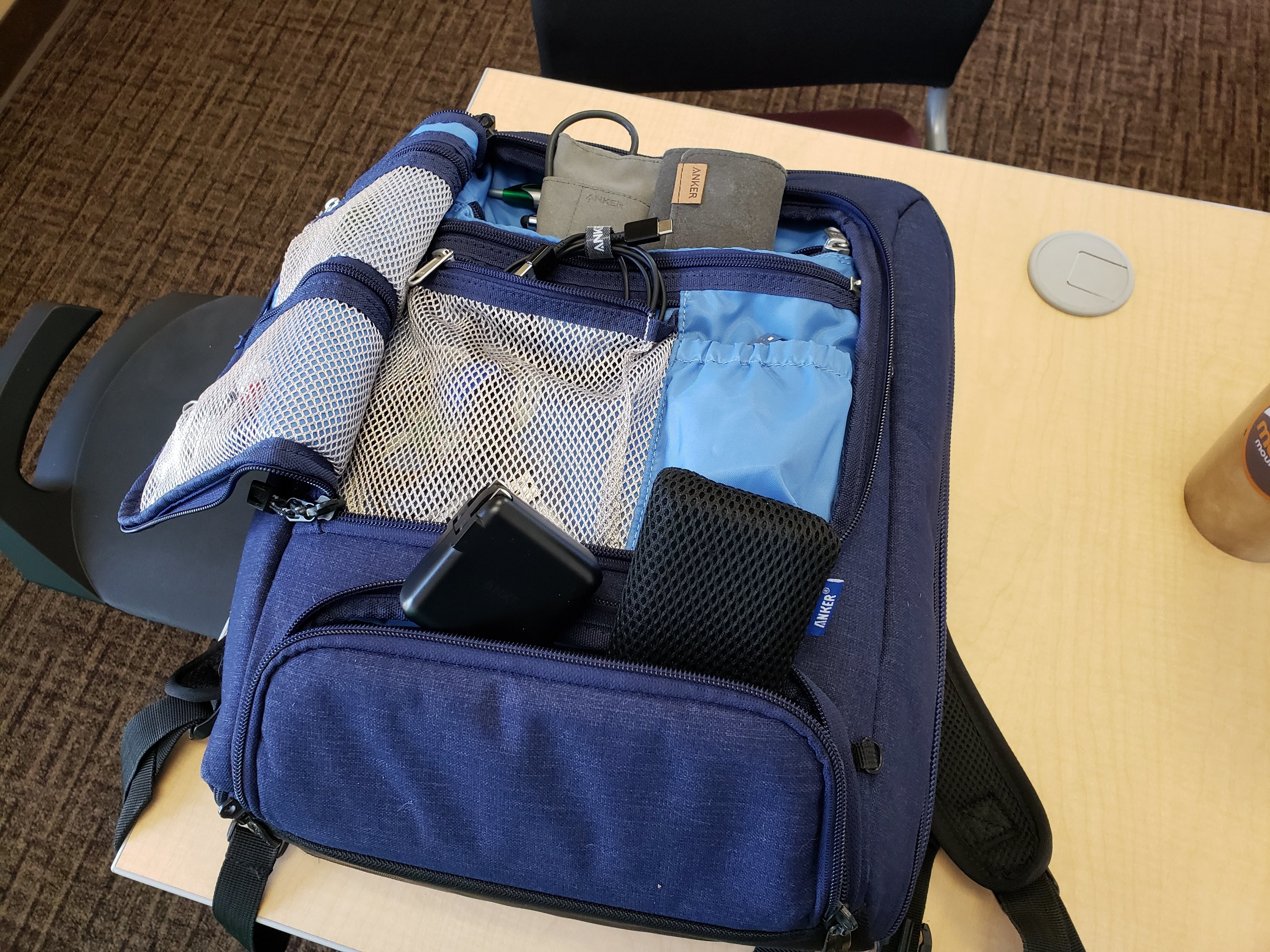

I carry regular lenovo laptop backpack, but store lot of Anker devices - Powercore 5000, SoundBuds Rise Headphones, Soundbuds Verve Built-In Microphone and PowerLine II 3-in-1 Cable – these are the bare minimum stuff I use on a daily basis,
