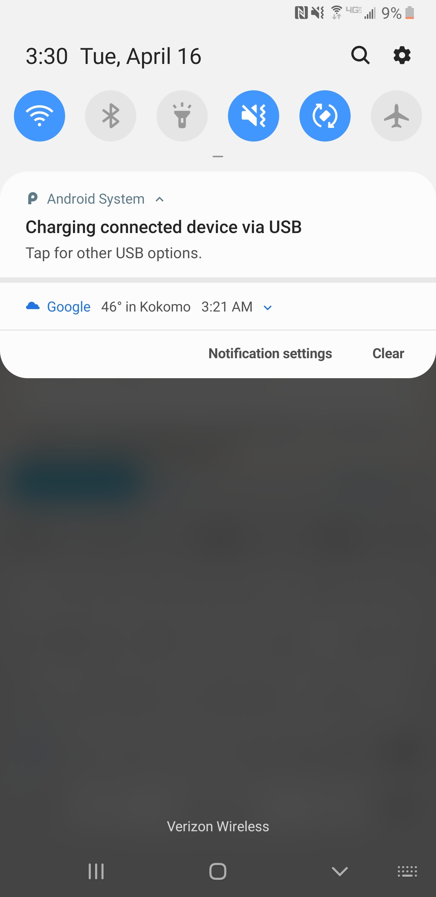

So I thought it wasn’t connecting at all. But actually on my phone it says.
Charging connected device via USB. Makes it sound like my phone is charging battery pack?
