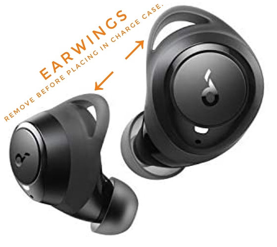

I use the biggest rubber earbud wraps (earwings), these will not allow the earbuds to make full contact in the charging-case, thus I have to take off the rubber earbud wrap (earwing) on both earbuds before placing in the charge case.
Then, they make full contact and charge and last a long time.
Have you tried this? Hope this helps, if you haven’t tried yet :slight_smile:
