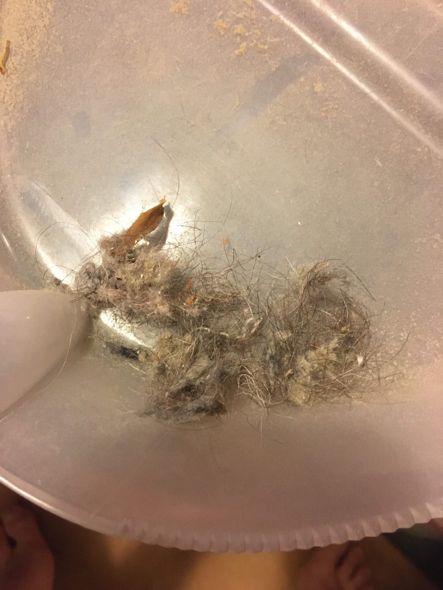

I was able to do this a slightly different and I think safer way. I fed a Velcro cable tie through the tiny wheel by pushing the Velcro in, then turning the wheel until it fed through. Then i used the tie as leverage to pull out the tiny ball and stick. I was able to clean everything out this way…and holy crap there was SO MUCH HAIR. This probably needs to be a regular maintenance routine.

I used a pair of pliers, I guess the exact type is “slip joint”. Pull straight up. The amount of debris, hair, threads, and dust under the swivel wheel was enormous. The Owner’s Manual should really stress the importance of this cleaning / maintenance step.

I would suggest not using pliers. I used small flat screw drivers on either side in the notch between the ball surface and the center of the ball. Just enough room for the flat to get in, you pull up on each side and it pops up.
When I did it the ball came up with the whole swivel ball that it sits in. This is okay the swivel holder has a nice steel axle, like a swivel castor on a rolling table etc… And goes in and out with a solid snap.
Anyway, I could then get the ball itself out by push with thumbs from the inside of the swivel ball. And it all cleaned up nicely.
Two things to watch: the little metal axle sits very loosely in the ball so watch out that it doesn’t fly out or fall in the sink etc…
Also under the swivel ball piece, there is a small, thin teflon washer that you need to make sure goes on the castor rod so it swivels smoothly. There is also a small amount of white grease that’s kind of clean but dusty. I cleaned out the dirty bits of grease, but tried to save it where it was clean.
