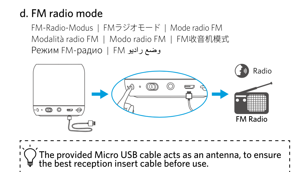

Hi there everyone! I have had my soundcore mini for many years but didn’t realize it had radio function until today. I struggled with the settings and found this thread. But I made it work! Here’s how. (Excuse my bad English)
Restart your speaker. Wait a few seconds before starting it again.
Connect your charger cable into the speaker, without the USB charger adapter you need to charge the battery, you seperate them two. The cable alone will work as an antenna. (See picture)
Press M (Mode) button on the speaker FOUR times (2-3 sec between the pressing)
You’ll hear a noise, that’s the radio! -
Now press in
2 seconds on your speaker. (This is how your speaker searches for radio channels.)
Press long
on your speaker to stop and save a channel. If you are searching for a specific channel repeat step 4 and 5 til you find the right channel.
Disclaimer: Make sure to be somewhere where you know there’s a good radio signal or else you might not hear anything
Good Luck!
