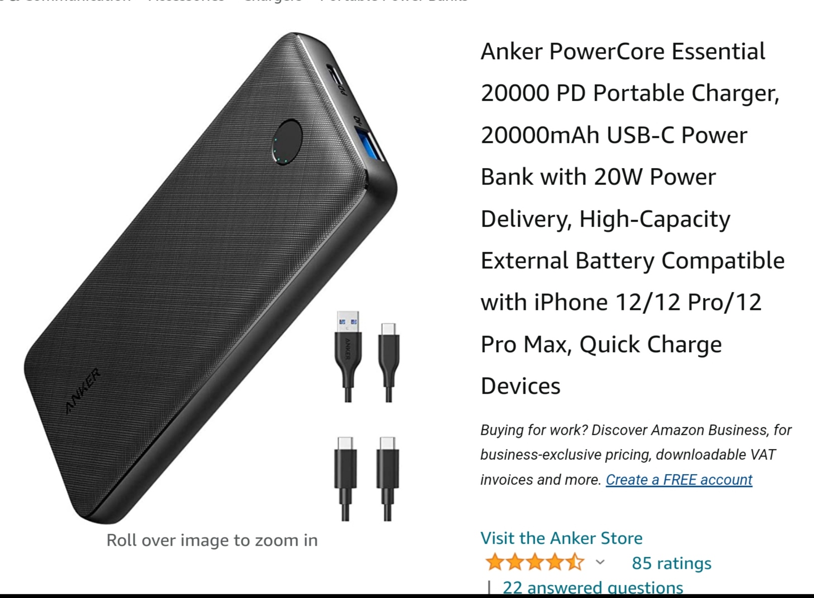

Not wanting to denegrate the product but personally I prefer just to own two slower, as then i have a spare and i’m not that fussed by speed. Two 20000 PD 18W are $50 if you’re patient.
Oh I am not patient at all lol. I actually have a 20k18w, used mostly back when I’m packing lightly. Problem with it is, it refuses to recharge on my tiny 20w Aukey usb c adapter. (Yes Anker if you released your 20w foldable plug earlier I would’ve gone with that). Shows receiving 15v but current is always near 0.
That Aukey itself has no issue with any other device, and the 20k18w has no issue with anything else except…
when I try to charge my MacBook Air with it, only ~12w is available and only half of its capacity is useable, if the power bank drops below 50% MacBook Air will only show plugged in not charging.
