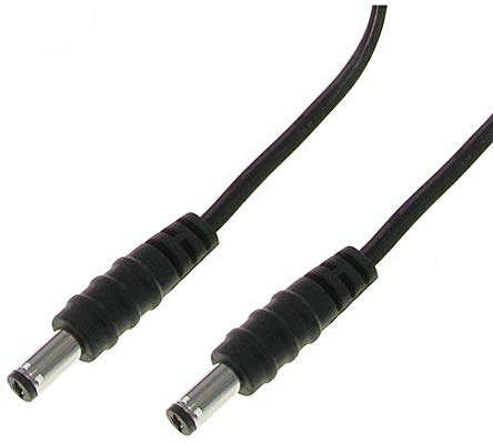

I have both of the following power banks. I have not needed them while watching a standard movie, but I will be bringing them for a weekend camping on an island. I have tested them both to make sure the output is adequate and they have both succeeded. I prefer the Renogy for purely allowing 12v cigar lighter output and multi-select DC voltage output, but lacks the two additional usb outputs. This can be remedied by adding a multi port usb plug to the cigar port. It is also important to note that the Renogy cannot be transported via airplane travel due to its size of battery.
Renogy 72000mAH laptop power bank
MAXOAK Laptop Power Bank 185Wh/50000mAH
Also to note is that I did like the volume of adapters that came with the MAXOAK, although I did purchase another pack of adapters for the 5.5x2.5mm tuning fork adapter and an extended 2.1x5.5mm cable.
Aceyoon Laptop DC Power Adapter Kits 38 PCS Universal 5.5 mm x 2.1 mm
Valley Enterprises 6’ Male to Male 2.1mm x 5.5mm Plug DC Power Adapter Cable 20GA
