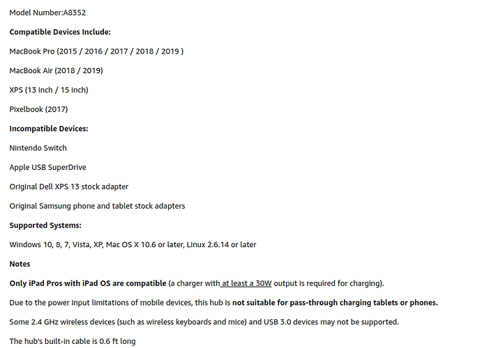

Did you buy the product code A8352 ? It is only 48W output and so would fully explain why only 40W, the laptop selected a mode nearest to 48W it supported, e.g. 20V 2A.
If you bought A8346 it is a higher Wattage version… and so much more of a mystery why 100W in gives 40W out.
There are 3 products. They give 80W from 100W, 85W from 100W and 48W from 60W. I just now spotted this too, two very similar products.
