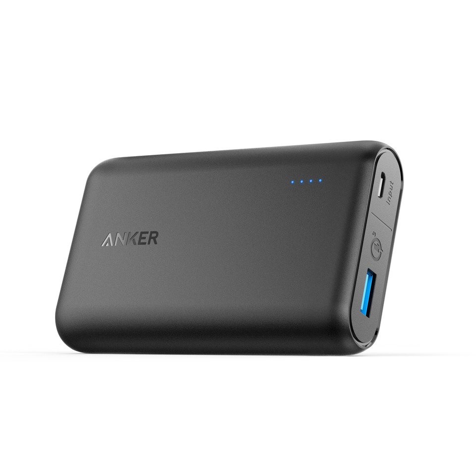

If it were a QC capable output it would be labeled as such, IQ is always reserved for non quick charge capable outlets. See blow for the Anker powerspeed 10000 that is made for QC:

@laurelwolf77 can you please upload a picture of the powerbank and the port on the powerbank that you are connecting to ?
