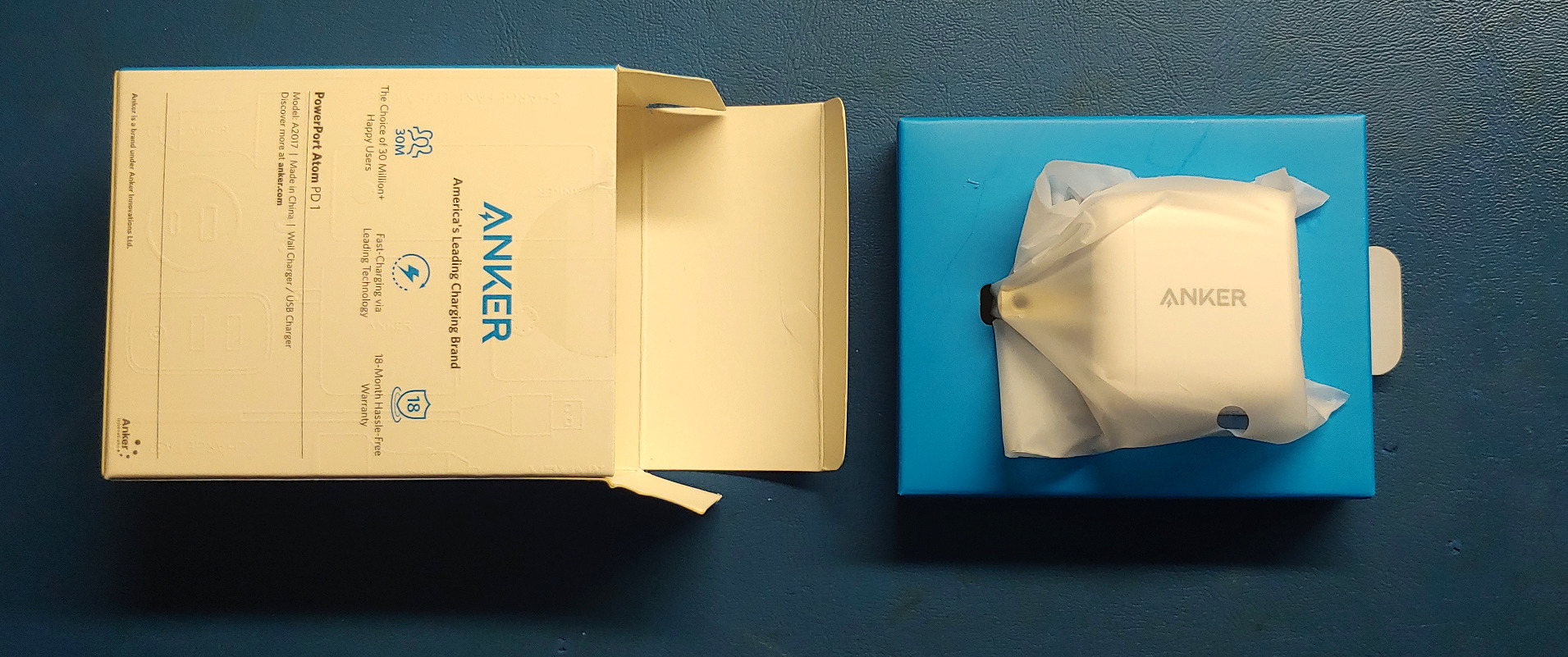

Initial unboxing was pleasant. Virtually no wasted area within the box, yet the device was well wrapped and showed no signs of being awkwardly smashed in. The box shut clean, the wrapper around the charger had a nice and sturdy feel, yet easily opened and came out without pieces tearing. The design is similar to the stock Apple 5W charger, with about 30% more size (considering it is 6 times more powerful this is a solid win). Once plugged in, the device only obstructs the port it is plugged into, making it ideal for outlets where one would require the second receptacle.

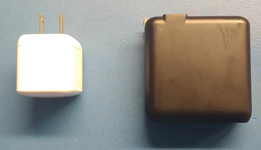

All 3 of these chargers were viewed by my device as comparable. When there was 50% charge remaining, any one of the 3 required 1 hour to achieve full charge, at 75% is was right at 39 minutes. The only difference between these chargers was the plug and the charger itself. There was zero variation between everything (which in my opinion speaks very highly of Anker as both of their techs easily paced the OEM charger). A side-by-side of the Atom and the Speed 4 below (The OEM device fits in between the 2 size wise):

That’s something I hadn’t considered. I took my Atom PD 1 and compared its prongs to an AUKEY PA-Y18 (18W USB-C PD, closest in size I have) and Anker’s older 30W USB-C PD charger.
The prongs on the AUKEY PA-Y18 (which fold) are longer. Hard to measure, but around 2 mm difference. The AUKEY weighs 1.5 oz, the Atom weighs 1.9 oz.
The prongs on the Anker PowerPort Speed 1 USB-C are the same length as the Anker PowerPort Atom PD 1. The older Anker weighs 3.6 oz, the Atom weighs 1.9 oz.
Based on that the Atom PD 1 seems to have a reasonable prong length. If you haven’t had problems with Anker’s older 30W USB-C PD charger then you won’t with the much lighter Atom PD 1.
I don’t know if it matters, but the Anker prongs end with a right angle while the AUKEY prongs curve.
