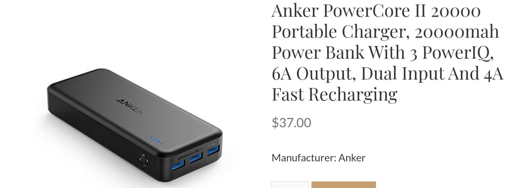

Anker only made two dual-input, both years ago, there is also the Powercore II 20000
It’s not particularly sold now, or shall I say I have doubt stock is new and batteries age so I’m less confident in recommending if you find one to buy.
