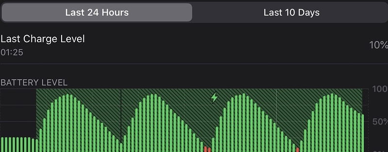

I’ve had an “Anker PowerPort I PD 60W 5-Port USB Wall Charger” for a while now and have noticed an issue when charging my iPad; it charges up to around 80/90 percent and then discharges down to zero while still displaying the charging icon in the status bar.
I’m attaching the graph from the battery settings. When I get the 10% remaining notifications is when I unplug and reconnect the cable, at which point it seems to start charging again.

We are sorry to know the problem with your wall charger. Please try the following troubleshooting to see if it helps at all.
  • Let the charger sit for 5 min without being plugged into the outlet and without anything plugged into the charger itself. This resets the charger and might solve the issue.
  • Try another cable and a different outlet.
  • Try charging a different device.
If the problem remains, please contact Anker Customer Support via support@anker.com to process a warranty claim.
Thank you! Resetting the charger has fixed the issue. I appreciate you taking the time to explain what I needed to do.
