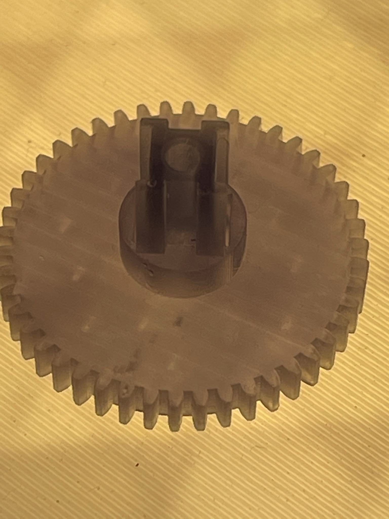

Was able to use the 3D files from Thingiverse and print them on my resin printer. It is way more accurate than a standard FDM 3D printer. hopefully these will work as well.
Good creativity. Report back how well these work so others know if to do same or avoid same.
Good work. Hope you used a perfect material.
