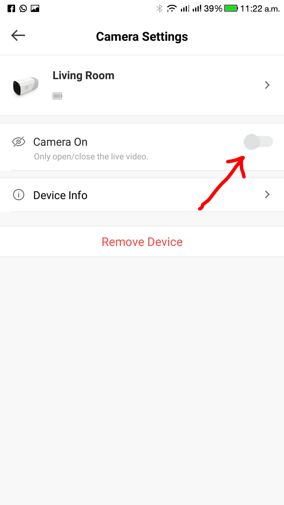

If you go to ‘My devices’ and click on one of the cameras ( as opposed to the homebase), the option should show up right above ‘night vision’.
When I go to My Devices and click on the camera, this is what I get.
Try removing the camera and re-pair!
I logged out of the app, logged in again, removed the camera, added it again, and all was well.
