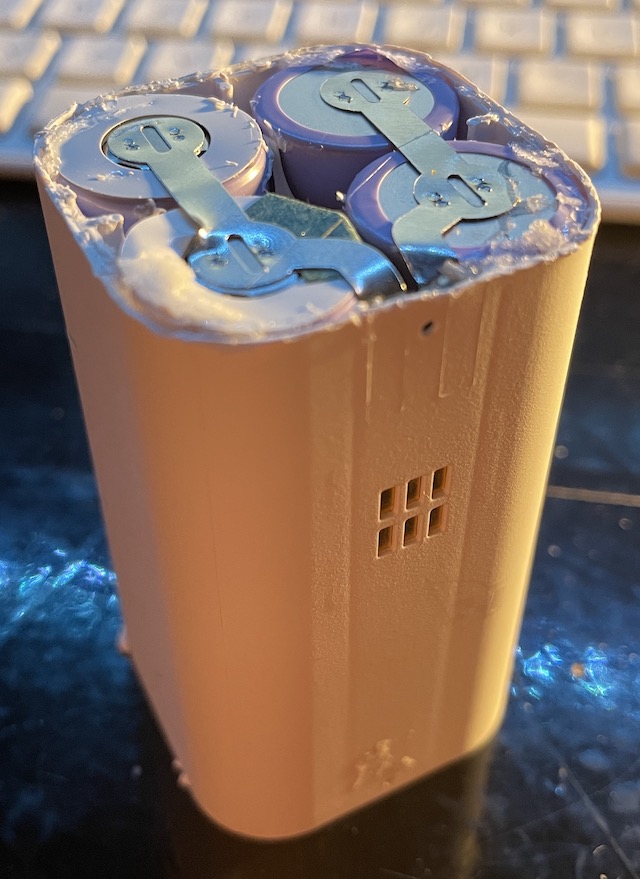

The housing has one access point and you literally have to pry it off. The batteries are set in a white epoxy so replacing the batteries will destroy everything…

Well the tear down begins…
Inside contains 4 LG 3350mah batteries, after testing with a multimeter 1 of the 4 batteries is bad. Now comes replacing the batteries without ruining the circuit board…lol
Edit: 2 of the 4 batteries are bad, not just one

It’s not pretty, but I replaced the batteries and wrapped it with electrical tape. Now the problem I have is the electronics do not recognize the battery percentage. I think I made the mistake of building this with fully charged batteries…idk
So for the past few days I ran the camera at max sensitivity and the longest recording intervals so I can drain the batteries until the camera stopped working. I then plugged it in to a usb cord to recharge it and the little meter shows the batteries are charging, but I get no battery percentage shown. I just get a " - " symbol.
I may take this apart again and reassemble it with discharged batteries to see if maybe the pcb needs a dead battery to start with or maybe I had a bad connection somewhere.
I finally got it working!
The tolerances are so tight with this camera, the electrical tape held the battery pack far enough away from the connectors to allow it to power up but not close enough for all the terminals to connect to the battery pack. I rewrapped the battery pack and now everything is working great.
I will also want to mention once inside of the camera, the white plastic is brittle so do not over tighten the screws or the plastic will strip or break.
