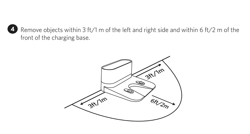

Anyone else.have this issue? Vacuum has never successfully returned home either on its own or when instructed to using the remote.
Odd one @alexdouds
Is the based placed in a suitably clear location?
If i remember correctly the base needs about 1mtr clear in all direction.
But also it could be the sensor on the front of the vacuum, mine is a dust magnet so I have to clean mine quite regularly.
Were did you place it?
if it is placed in another room it can take more than a while
and it should be really stand “free” same it is published in the manual.
You can check it if you place the robot in the same room the charging station is
and “send” it charging via remote.
