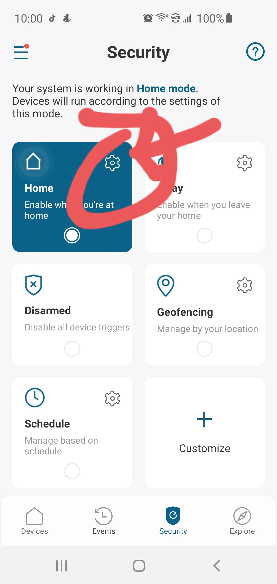

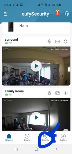

Not sure on IOS, but on android you have to go into the app and click in security at the bottom
Then click on the gear icon for whichever setting you choose

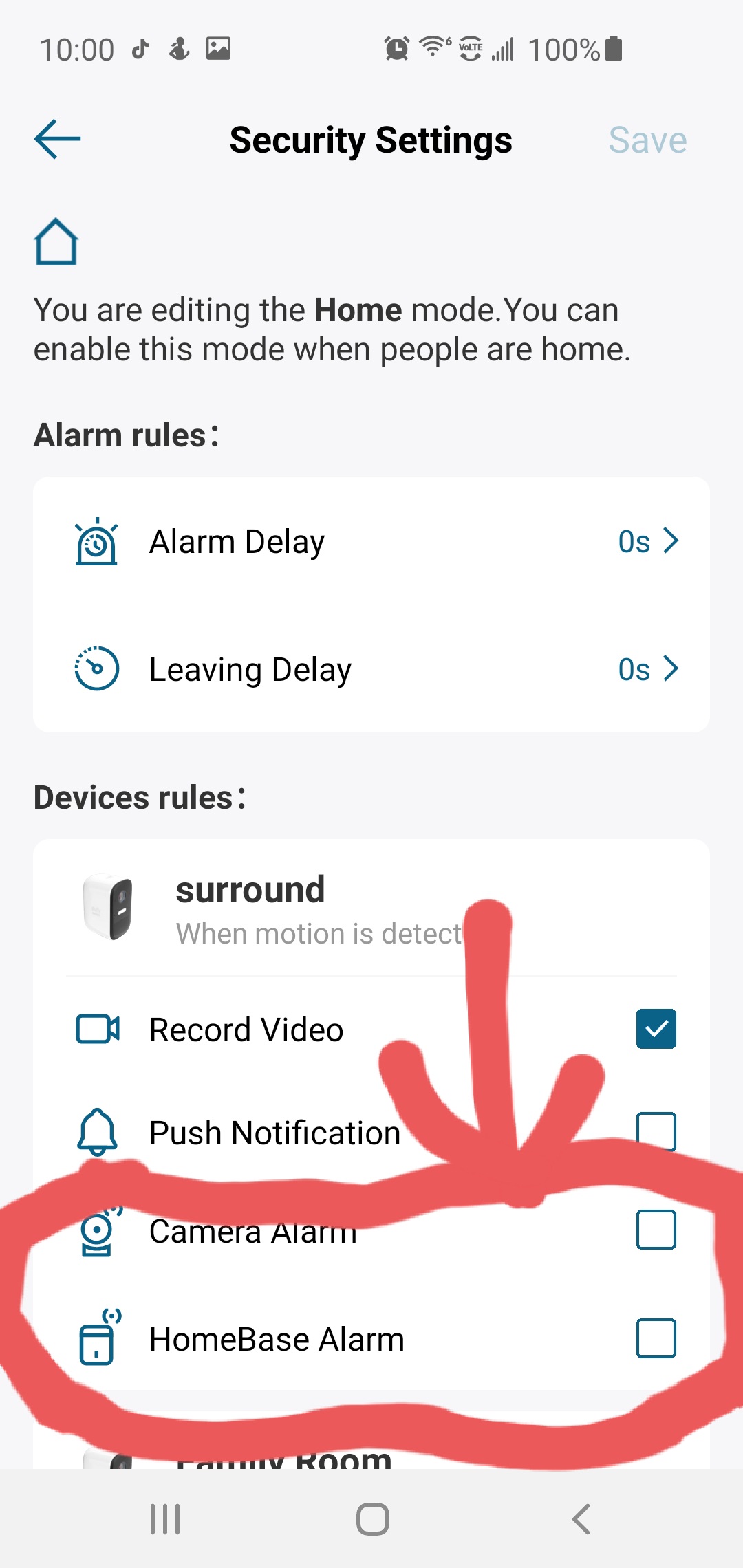

Then select alarm for camera/homebase or both… mine are disabled when we are home
I have the Geofencing setting selected, and there the Camera-Alarm toggle is absent, and I didn’t think to check the settings I wasn’t using…
I’ve unselected the toggle now it in the (unselected) Home selection, let’s see if that works!
