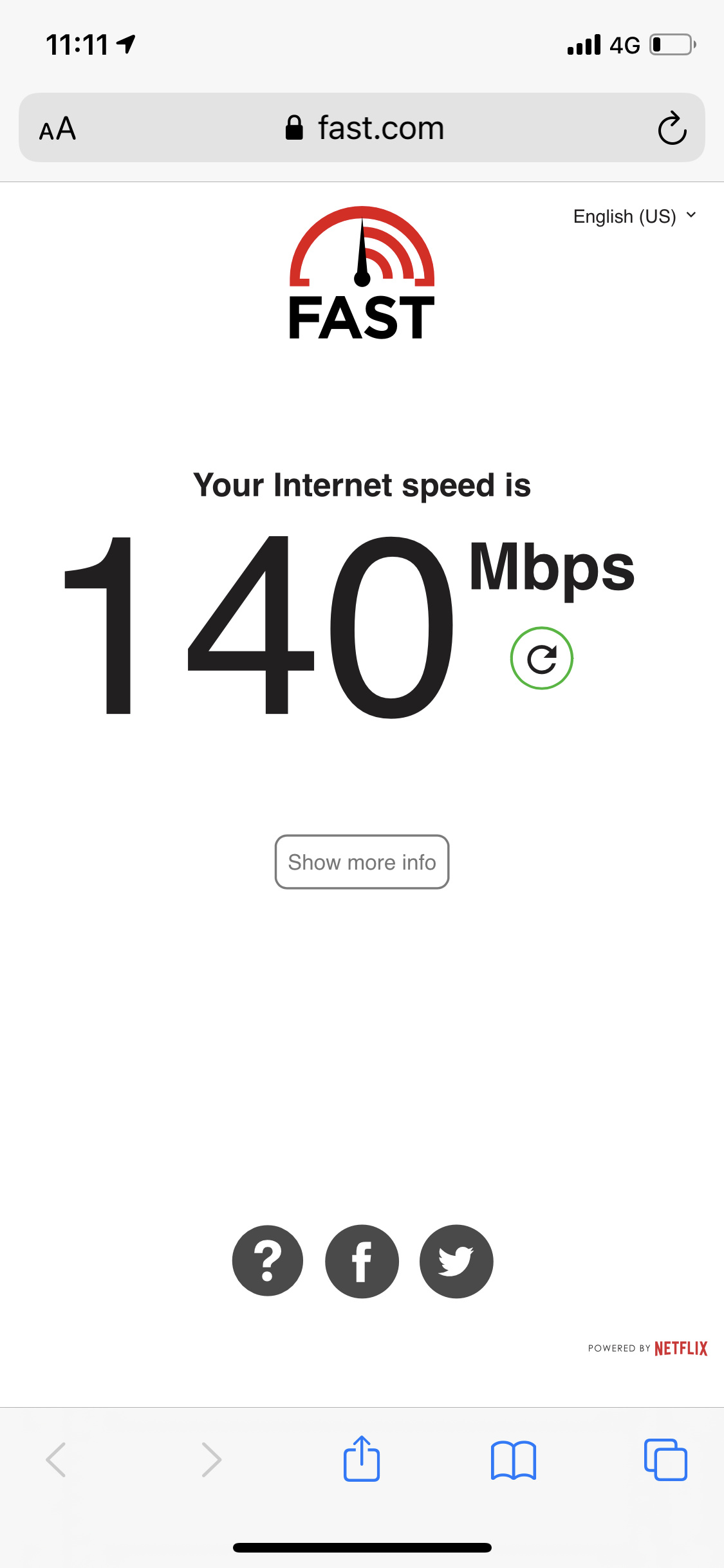

I can also confirm that my 4G network is providing good speeds of +100mbs, so this shouldn’t be an issue.
