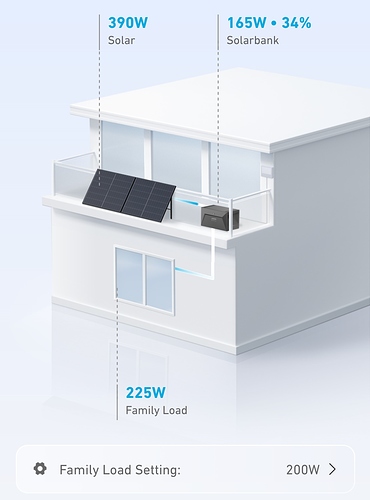

Hi! I had exactly the same thought as you and tried that on Saturday and even though it is not perfect it works much better! Picture below.
Unfortunately I could only try it for some hours and it has been cloudy since then. I will report when the sun is back.
