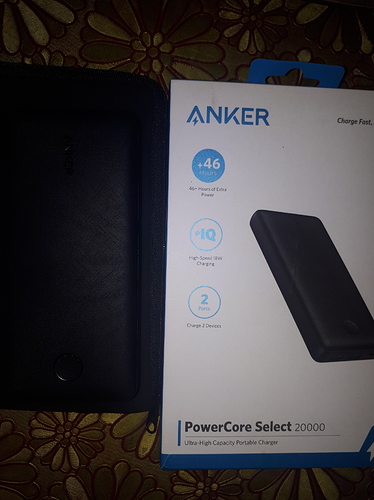

Hi guys! I’m new here in the anker community but i love anker as their powebanks have so much power despite having a long charging time. So i recently bought the 20000 fast charging powerbank and i tested it and it had around 5 charges for my phone which was great! I charged it and as it was on its last bar i fell asleep for about 7-8hrs and i saw that my powerbank was full but i then got worried because i feel like it overcharged and that could lessen its battery capacity? So my question is is this possible on this particular anker product? Or do i have nothing to worry about? Thank you all in advance!!
