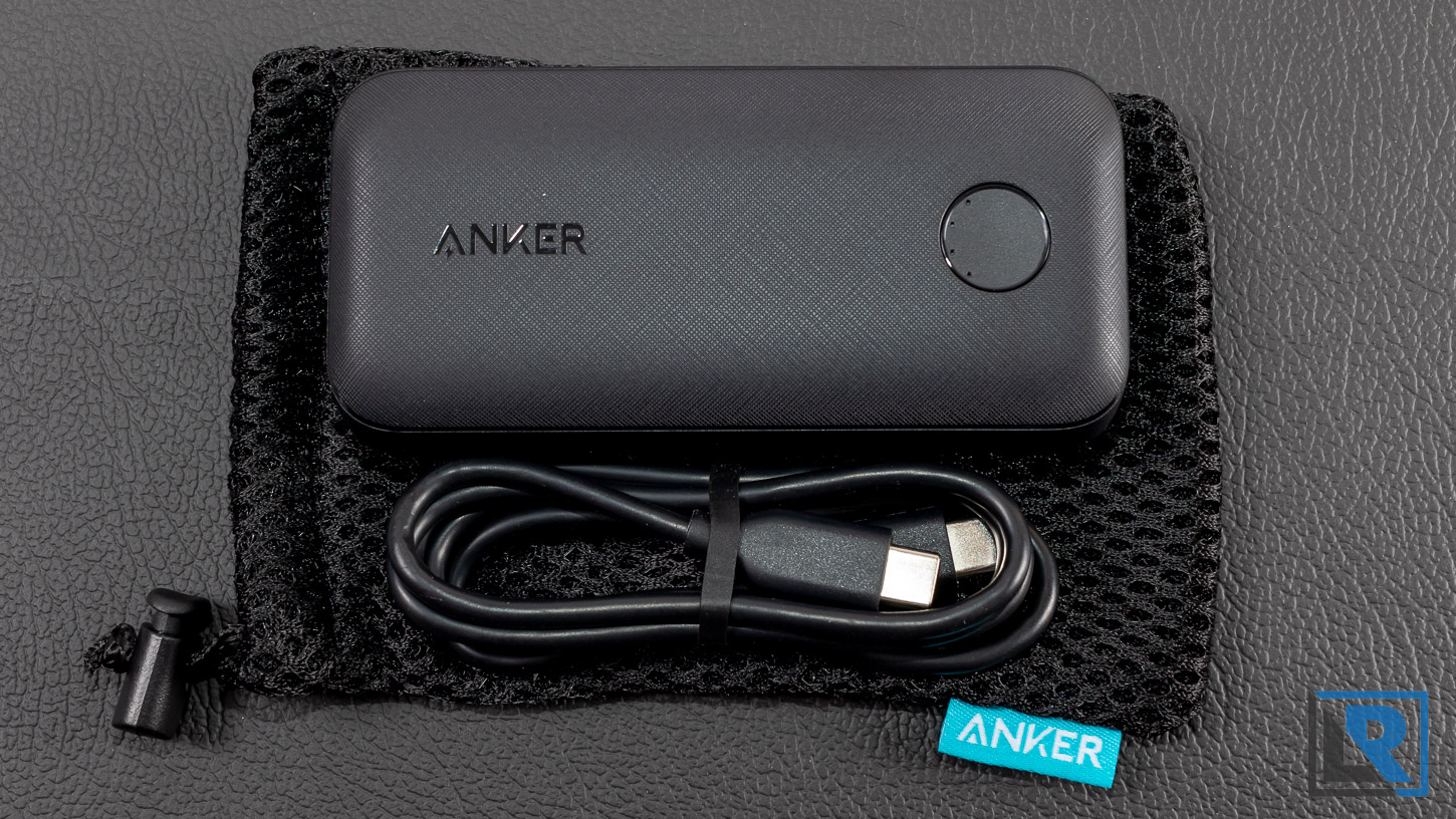

The packaging was standard blue and white and as a compact premium feel. In the box you get the powerbank, a mesh bag, and a USB-C to C cable that’s approximately 3ft long. Everything is covered by Ankers 18 month warranty too.
