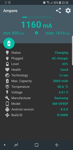

When we’re talking charging speed/power, can so done tell me, if the stats in this pic any good?
Can you offer anymore info possibly? (Charger type, age of device, etc.) Just a simple look at it for face value your battery looks solid (good condition, low operating temperature). On the charge side, your current has a large amp swing (assuming regular vs fast charge) which looks inline with most chargers outputs. I would say yea it looks fine.

I don’t know much about the charger, other than it has 4 outputs and made by energiser (shhh! :shushing_face::shushing_face::shushing_face:)
The lead, as far as I know is a usb-a 2 (maybe a 3, but even with glasses was too small to read) to usb-c.
Thanks @Monk3e
It’s shared with fiancée charging her Moto G (via a 3 meter usb extension round the back of the sofa), and a spare micro for headphones, powerbank etc.
I would use my pd usb-c, but only 2 outputs, and the only usb-c/usb-c lead I have is a slow one. So for now, I’m using this! lol

I have a galaxy S8, and even using the of usb-c, it won’t fast charge, due to having a slow lead.
However, when I use a usb-c/a lead in same charger it goes faster, as it’s a better lead.
