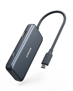

I bought the A8336 4-in-1 adapter b/c I could charge my Lenovo laptop while plugging in my wireless mouse and keypad. Except it’s NOT. At first, it simply wouldn’t acknowledge it was plugged into the charger. Now it does acknowledge it (shows the plug icon, says “charging”) but the battery is going DOWN. Is there something I need to do? The laptop charges when I plug it directly to the charger. I don’t see any support available anywhere. Anyone know where I can get help???

What charger are you using to power the hub? You might need a stronger charger as the hub itself will have a power loss and then the peripherals also draw power taking away from the main charging the laptop
OK, I didn’t realize that. Thanks. I have a Lenovo Yoga 910. I’m using the charger that came with the laptop. What can I change it to?
Your laptops draws around 45w, fully loaded it can draw more. Add the hub and accessories it would be best to get a 60w charger.

They said they had the A8336 and as far as I can tell that provides 60W of power
So it should be enough for the Yoga if the Yoga only needs 45W
That is just a hub itself, you still have to power it up and if they are using their laptop plug then it wont provide sufficient power given that it’s a 45w plug. You still have to provide and use an external plug than can provide up to 60w of power, hence the plug I recommended above.
