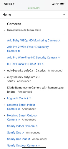

@AnkerSupport - might be worth updating the information on the Apple HomeKit page. Still showing as ‘announced’ now it’s live and out of beta, perhaps showing as implemented would be helpful.
