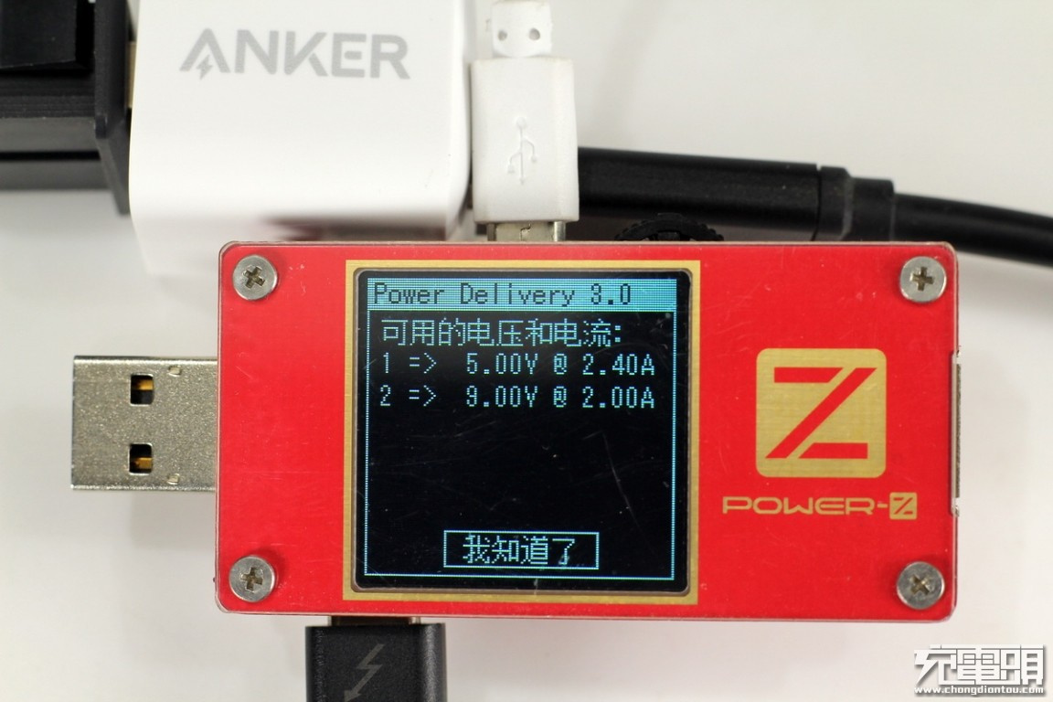

It may have already been 20W as when I measured it I was getting >18W anyway.
Tear down
http://www.chongdiantou.com/wp/archives/57910.html
You see
Which means it is capable of 22W.
I noticed that some of the amazon titles still indicate 18w while the updated images now state 20w. What is the difference between the new and old nano? Is it firmware related or a physical update, and has the model number changed?
It is answered above.
Here is the 18W teardown
http://www.chongdiantou.com/wp/archives/47221.html
Here is the 20W teardown
If you look side-by-side
  • product code changed from A2616 to A2633
  • The max current 2A to 2.22A (although note in my own tests of the UK Nano I was getting > 2A anyway already)
  • it appears, but I’m not 100% sure, to be slightly smaller and slightly lighter. The front of it is changed colour.
  • the original Nano had “too good” a chipset in it capable of 50W much higher than 18W, they’ve since used a lower end version capable of 27W. That doesn’t mean it’s inferior, it could simply be a supply issue at the time of the 18W, and different batches may have different chipsets and the teardown may not be representative so don’t attach too much weight to this point.
  • the rest of the components look identical at a cursory glance.
  • my opinion is the hardware was always capable of 22W they just tested it and sold as 18W and then made a slightly different one tested and sold as 20W. I’d not suggest to anyone owning the 18W to rush out for 20W, as charging elapsed time will be only minutes different. At most the 0%-80% charging period, which is half of total charging time may be 10% faster so meaning 5% faster from 0%-100%. But of course if you’re buying now, if the prices are the same, go for 20W.

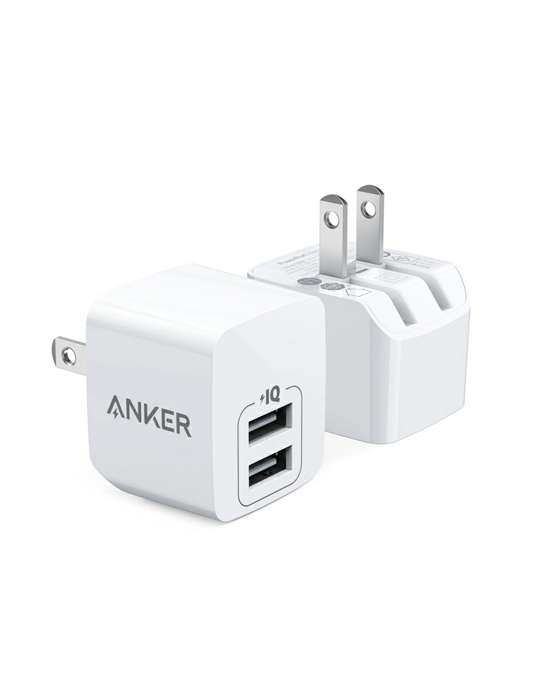

For example I’m expecting a do-over of these
Currently these are more than double the size of the nano when they should be a little larger than the Nano.
Where can I buy this 20W PD version (shown in this picture), I don’t want PiQ version.
