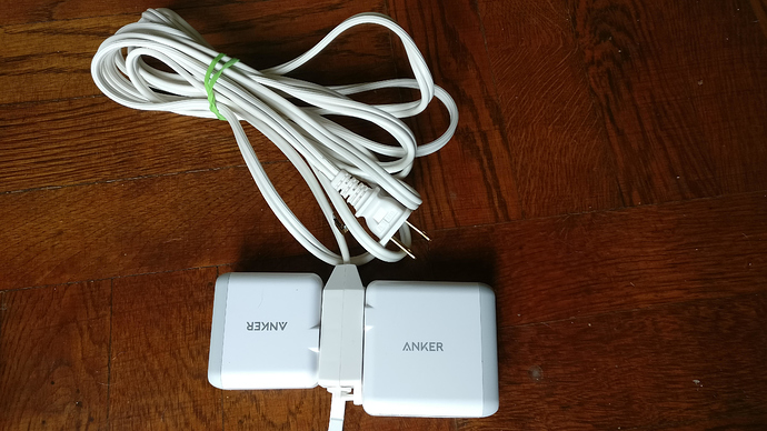

Here are some size comparisons of different options.
Shown is:
  • Aukey 12W dual-port charger
  • Anker 24W dual-port Powerport2 (not the Elite)
  • Anker 40W 4-port Powerport4
  • Anker 40W 5-port Powerport5 USB-C
  • 12ft extension cord
Example of using the 12ft extension with the Powerport2 and Powerport4 to make 6 ports of 64W combined. The extension cord can plug in 3 items at once but the Powerport block a port so its 1 each side to make max 2 connected.
If:
  • the wall socket is near by your devices (e.g. desk socket) then the smallest simplest are the Aukey (if need 12w / 2 sockets), Powerport2 (24W / 2 sockets), Powerport4 (40W / 4 sockets) as they are simple devices with folding pins and in this context you need short USB cables, so overall a small simple package.
    Else if:
  • the wall socket is a few week away, the Powerport5 (and hence the 6 and 10 port bigger versions) are the next simplest, you have the supplied 5ft cord to the wall socket and then the Powerport is next to your devices, also on short USB cables
    Else if:
  • the wall socket is far away, say 10ft away, then use the extension cord to get it like as per right next to you, then use the 2-4 port, in combination to get the ports and Watts you need.
When I travel to an unknown location, I take the 12ft extension cord as it allows for maximum flexibility, then depending on how many devices I have, the required port capacity from the individual chargers. A common one for me is the Powerport2 and the Aukey as then 4 ports 36W to charge phone+tablet+powercore+BT.
