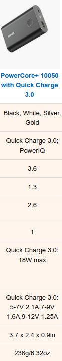

At the moment a QC3 input and QC3 output Powercore+ 10050 is $30 in USA
https://www.amazon.com/dp/B01K6T7AFM/?kinja_price=30
Cons:
  • its heavier, bigger
Pros:
  • it will recharge itself faster using whatever QC charge you use now.
Now why I didn’t recommend first in your context is you said off-grid so you won’t have the chance to recharge it during your trip, plus recharging it calls for the charger to be also carried, adding backpack weight. The absolute lowest weight is as per your last post the Powercore 10000 and the Powercore 10000 Speed, although if you’re counting the odd half ounce two Powercore 10000 would be a fraction lighter.
