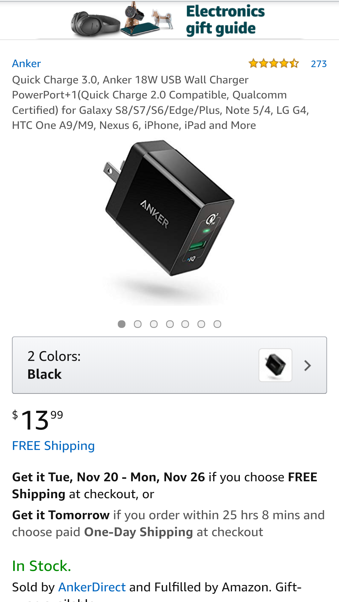

This one is future proof and has a 30w type c output and a 19.5w regular USB PIQ2.0 USB-A port.
Basic quick charge single quick charge 3.0 port
https://www.amazon.com/Anker-PowerPort-Compatible-Qualcomm-Certified/dp/B077HFFLMS/ref=mp_s_a_1_6?ie=UTF8&qid=1542221225&sr=8-6&pi=AC_SX236_SY340_QL65&keywords=anker+wall+charger+quick+charge+3.0&dpPl=1&dpID=41WV7jg5MxL&ref=plSrch
Car charger bottom port is PIQ 2.0
Thank you for the links, the first one looks good indeed. Will buy it today.
You bought this?
Well it recharges at QC3 speeds so you bought therefore the wrong charger. IQ2 includes QC3 so you need either an IQ2 or QC3 charger. You bought this?
You should have bought either of these:
So if you did buy a QC3 recharged 26800 but not a QC3 charger then it would be giving likely 10W out not 18W out so you’d get slower than the fastest 10 hour charging and probably 16 hour charging.
