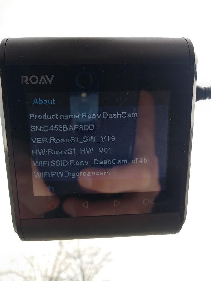

Support sent me version 1.9 last night, so i am going to test it out today.

No luck whatsoever, in fact it actually crashes faster on this version with bluetooth enabled and being connected to my car.
