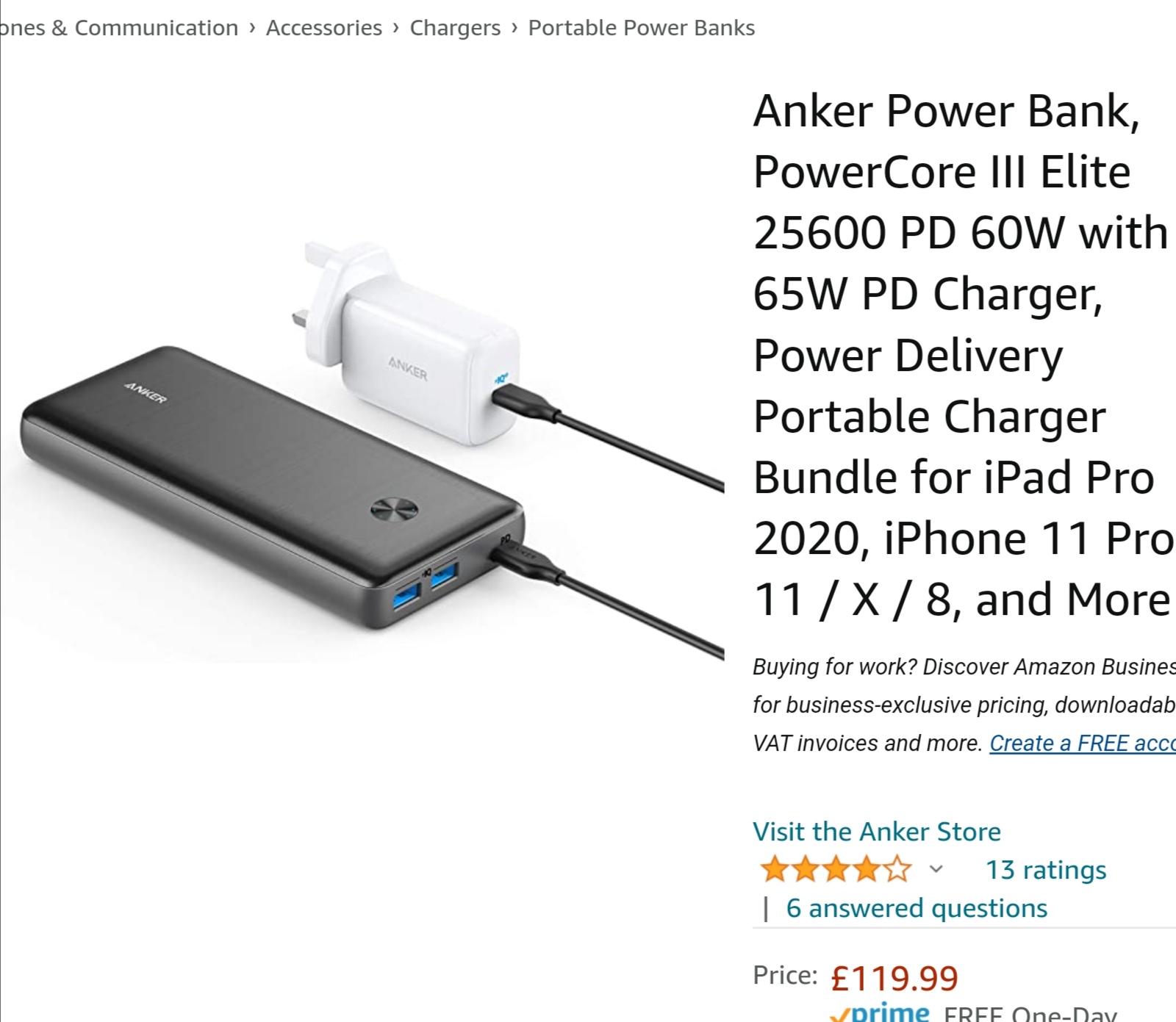

Odd you have 100W charger as they are bundled with a 60W-65W charger.

This Powercore says
So it’s 3 hours for 60W. You didn’t need to ask that.
