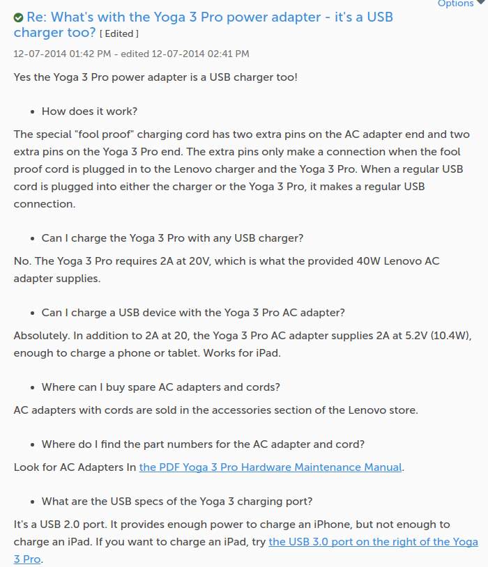

Unfortunately, it looks like the Yoga 3 requires a 20V input, which the PowerCore (and most USB chargers) only supply 5V. So while the Yoga 3 charger may look like a normal USB charger, the Yoga 3 actually has unique power requirements outside of the normal USB specs. I found the following details on the Lenovo forums.
Can I charge the Yoga 3 Pro with any USB charger?
No. The Yoga 3 Pro requires 2A at 20V, which is what the provided 40W Lenovo AC adapter supplies.
Looking at the sticker of the PSU you see it has 2 output types, the 20V 2A and more regular USB 5.2V 2A. I expect that is why they gave it a USB socket. It would sense it was connecting to a Yoga 3 and move up.
I compared with USB-PD and its not a match so it appears Lenovo proprietary but that’s where I stopped digging.
So any annoyance would be to Lenovo for using proprietary energy output types so that the likes of Anker don’t have a business model to support.
