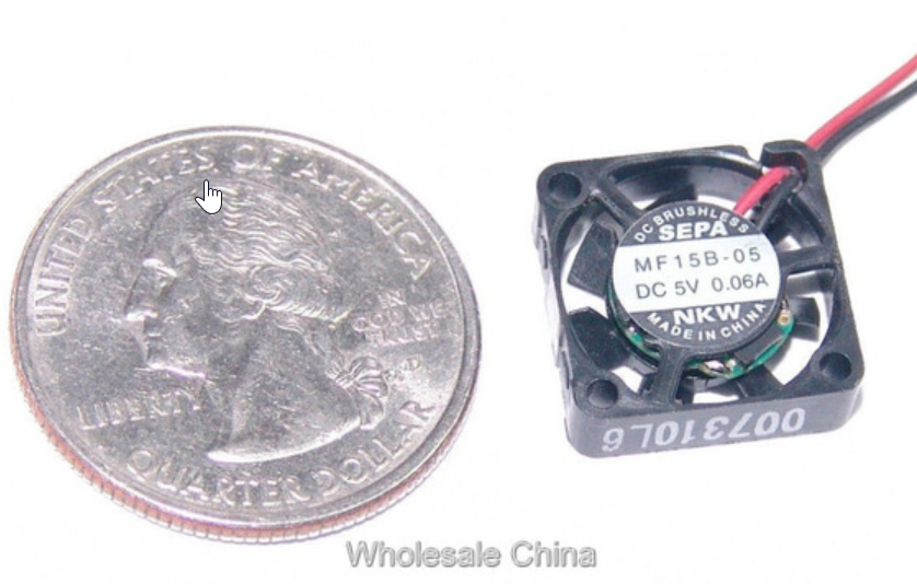

Just good venting and a mini fan that turns on when plugged in or when the temperature reaches 60C. They make very small fans. @ankerof
