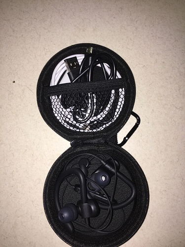

Pouch test
I never really saw anybody reviewing or testing the pouch. I like the pouch. I have found that I can put my Anker iPod cord in the pouch with my earbuds. I would like to see a pocket on the other side so that I can have my Aker cords on one side and Spirit chargingcord on the other side.
Now I did do a floating test with the pouch. I put my earbuds, and cord in the pouch, I had a pan full of water and placed the pouch on the water. It floated. For me this is great to know the weight of the cord, earbuds and pouch was light enough to float on water. I have some upbeats and despise the pouch (or as I call it - “the granny purse”) and know that they would sink like a rock.
Other than a second pocket, I give the pouch a passing grade
