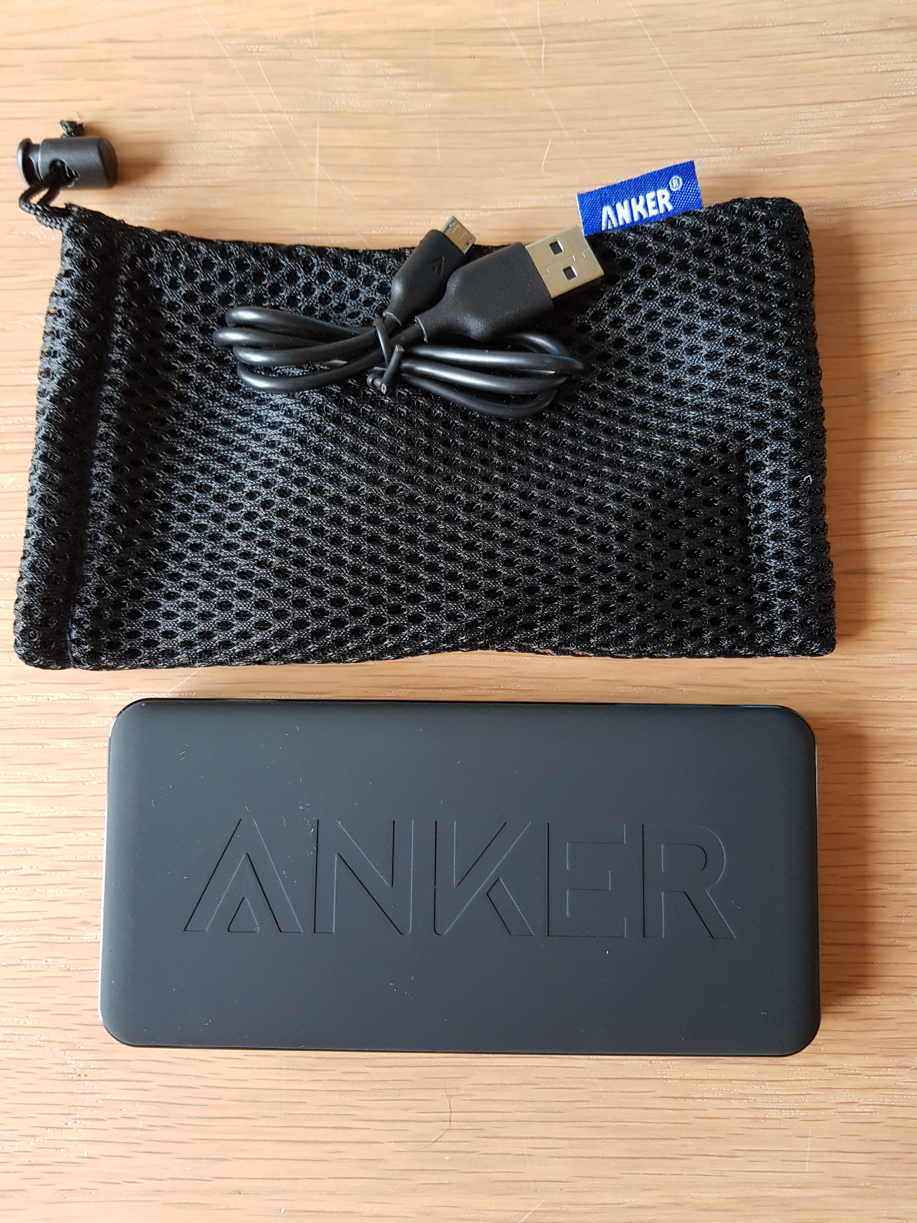

I have received this Anker PowerCore II Slim 10000mAh as part of the Power User programme.
It came in the icon blue and white Anker packaging, nice and compact not much waste. Inside the box is the welcome guide, carrying pouch, Micro USB cable and of the PowerCore II Slim 10000mAh.
As soon as I got it out of the box I was very impressed with the build quality and how small it was I like that is has the matte plastic on one side and the other side has it has a soft rubber. Really like the idea of the soft rubber as this is small enough to fit in your pocket with your phone you aren’t worried about your phone damaging.
The closest charger I have to compare this to is the Powercore+ 13400. The PowerCore II Slim 10000mAh feels a lot nicer in the hand and is a lot lighter. I can get over how thin the PowerCore II Slim is.
I use this mainly with my S8. There isn’t much of a size difference between them at all, if you have them in your jeans/trouser pocket you can hardly tell both of them are there. I wish because they are so similar in size and feel so comfortable together that wireless charging could have been added. I don’t know if it would even be possible but because my S8 supports wireless charging it would have been one less cable in my pocket before having to recharge the PowerCore II Slim
The charging time is really quick with the PowerIQ, charges just as fast as the wall charger that comes with the device
I would definitely recommend this product to anyone commuting or travelling. It’s tiny and has enough juice for 2/3 charges
