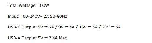

Ok, so it looks like the USB-C ports themselves are capable of outputting up to 100W. Both A ports are PowerIQ 1.0 so capped at 12 each. That leaves 76W for PD when both are in use.

Yes that seems to be case from this:
So you see there a 20V 5A 100W mode, so yes single port used gets 100W.
The lack of clarity is how it shares it “intelligently”. Assuming these are all the PD modes then imagine two PD devices, well then you’re looking at a little wasted power because for example two ports at 15V 3A 45W leaves 10W wasted. So if you used 2 PD ports you’d need something wanting no more than 10W to be happily using all the power.
You can imagine say you had one PD device and something non-PD well if these specs are the full information than that 20V 5A 100W has no choice but to come down to 45W and the simple act of plugging in anything to that Type A ports which cannot take more than 5V 2.4A 12W means you are using at most 45+12=67W so 33W are wasted.
So there must be more to this than the Amazon blurb. They must be keeping voltages at these discreet levels and reducing current to not have wasted power?
The issue then is the interoperability with the PD devices, imagine Anker in the 1 PD + 1 A scenario gave 12W to the A port so 88W left at PD port well you’d to give out 4.4A 20V not 5A 20V, so how would the device feel about only 4.4A at 20V? Would it then decide itself to go down to 15V and so only take 45W and not 88W?

Oh I know you can lower current, but what does the device connected think of that? It is a negotiation which be a race to the common bottom denominator.
You’d need an intelligent device to get the best out of the intelligent Atom-4. e.g. device is perfectly happy at any voltage any current within certain minimums, so a device capable of 100W saw 20V 4.4A would be perfectly happy. At some point, say around 2.3A, if current dropped it would ask to renegotiate as there is a stepping-down inefficiency in the device of needlessly high voltage and so may take 15V 3A instead and everyone gains less heat waste.
I don’t see anything more we can do that just check our device compatibility in reviews or wait for Anker to list them and if it doesn’t work then instant refund. At these prices ($80 I suspect) it is an expensive experiment.
It will take a while to be sure.
Sort of, the renogotiate comes if the current is too much (in my case my v35 adjust down to 9V1.8A with PD and QC). If your supply is 5v1a supplied to a system that takes 5v2a, provided the voltage is there it wont care much. The chipset sets voltage to make device happy and then feeds current. Heck, you could put 20v1a and your device shouldnt really care much, just take forever to charge. The voltage levels are most important, the handshake sets up what voltage a device can take. QC does this, but after getting voltage will repeatedly ping and adjust current to get optimal level, if you attached one that could handshake but needed higher current then the charger would lock at max current and be done.
