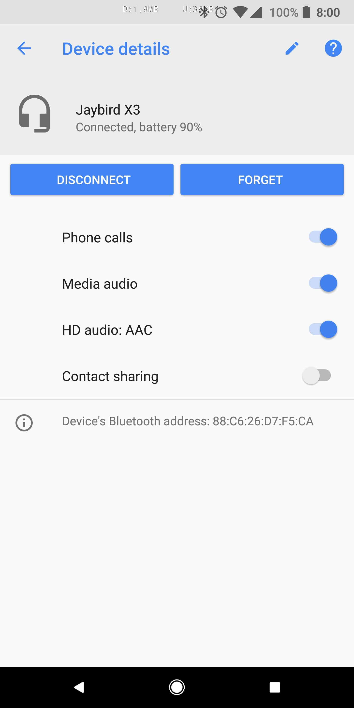

Are you sure AAC isn’t supported? When I owned my Pixel Buds, in those same settings you mentioned, there was a 4th connection option turned on called “HD Audio: AAC”.
I found a screenshot from a Pixel connected to a pair of Jaybird X3’s to show you what I mean.
I wouldn’t care if it was actually shown in the settings or not, but there is absolutely a difference in sound quality between devices that support AAC and those that don’t, much the same way AptX and AptX HD devices do.
